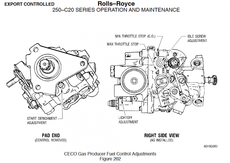

It's already documented in the Rolls Royce 250-C20 Operation & Maintenance Manual. The CECO was designed to start without any modulation, if adjusted correctly. It was also designed to allow, unlike the Bendix FCU, a modulated start. Below are excerpts from the Rolls Royce manual.
Set it up correctly and it will start without modulation. Note those two adjustments on the CECO "Start Derichment" & "Light-off Adjust"
Click photo to enlarge

That's correct...
Rolls Royce 250-C20 Operation & Maintenance Manual (72-00-00 pg. 62)
The 250–C20 Series engines each have two qualified control systems; they are:
(1) CECO.
The MC–40 (250–C20, –C20B, –C20J) control system manufactured by the Chandler Evans Control Systems Division of Coltec Industries.
(2) Bendix.
The DP–N1 (250–C20) or DP–N2 (250–C20, –C20B, –C20F, –C20J), (control)/AL–AA1 (governor) control system manufactured by the Bendix Engine Controls Division of Allied Signal.
C. Starting Modes.
Starting procedures are given for an automatic start mode (CECO or Bendix system) and for a modulated start mode (CECO system only).
Automatic Start Mode:
The throttle is advanced directly to the IDLE detent when desired N1 cranking speed is reached.
Modulated Start Mode:
The throttle is advanced toward the IDLE detent in increments as required to increase TOT and N1 speed at a steady rate that remains within specified limits.
Rolls Royce 250-C20 Operation & Maintenance Manual (73-20-04 pg. 207)
F. Lightoff Adjustment
Make the lightoff adjustment by trimming the screw with a 5/64 in. Allen wrench to obtain engine starting fuel and exhaust gas temperature requirements. Turn the screw clockwise to decrease lightoff fuel flow.
G. Start Derichment Adjustment
The start derichment adjustment can be used to modify the starting fuel flow to improve cold weather starts, stagnated starts, or high altitude starts. Make the adjustment using a 1/4–in. Allen wrench having a 1/2 in. (13 mm) offset (or CECO wrench STD 67181). Turn clockwise (when viewed from end of adjustment screw) to enrich fuel flow for faster and hotter starts. Turn counter–clockwise for leaner fuel flow when starts are too hot. The normal setting is with the travel limiting screw at bottom center. Check the starting peak TOT after each setting until satisfactory starts are made.

Though we’re talking about a different engine and fuel control unit from that of the Bell 206B, the Bell 206L has also been troublesome to many during the modulation sequence.
Rich (hot) starts have been a problem. Causes like weak battery, delayed ignition or premature opening of the throttle are common. However, hot starts due to high fuel flow are normally caused by the fuel control. When you have an over-sensitive and hard to start Bell 206L (250-C30 engine) it could be a fuel control issue. Therefore, we’re back to maintenance and adjustment or even replacement of the fuel control.
Some companies have made it a culture of living with marginal aircraft maintenance, if it’s not completely dead, it’s good to go. Or terms like, we’ve been fly it like that for years and no one has a problem with it.
When the fuel control is suspected, ask maintenance to make the adjustments. Note the heading in the table below, “Adjustments to Improve Stating
Regards,
Chris
