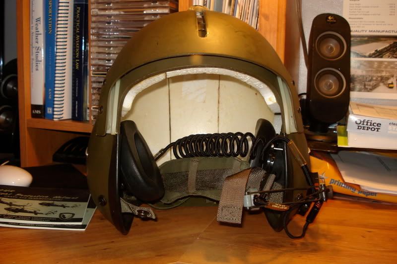

Some pictures....
The APH-5...

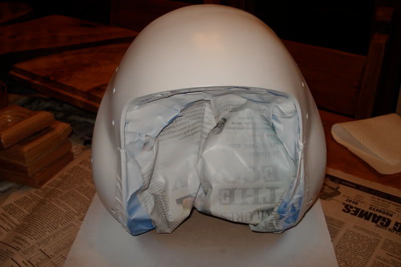

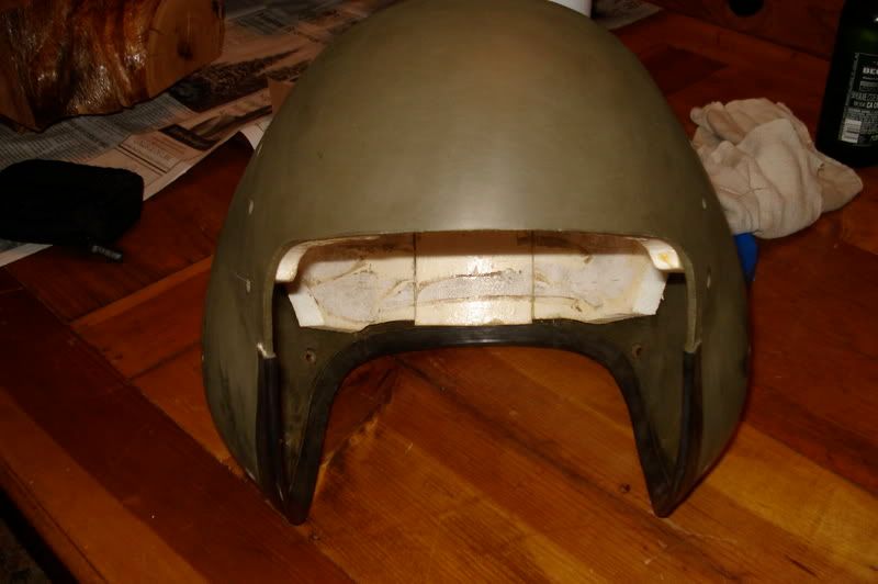

The AFH-1... This is the one that I'm going to use. Right now its stripped down ready to get prepped for painting.

*Status: Just received its first coat of white paint and will be ready for a second coat in a few minutes.

By stripped I meant that I removed all of the components except for the styrofoam liner and edge beading. I sanded it with some 150 grain paper and masked it off. I just put a couple of coats of gloss white Rust-Oleum plastic paint on it today. Tomorrow I'm planning on sanding it with some finer paper and doing a couple more coats. Then I'm going to attempt some sort of metallic blue stripes (if I can mask it off well enough). Then I'll seal it with some Rust-Oleum crystal clear enamel.

*Status: Painting is going well so far. I applied a couple more coats of white today. It's starting to look better already. Clean. A little more sanding tomorrow and it should be time for the final coats before my design and a clear coat.

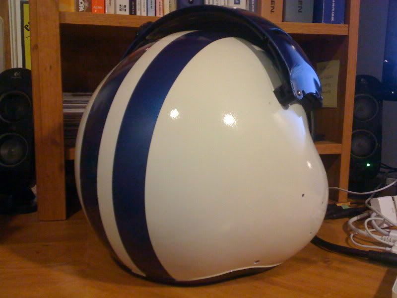

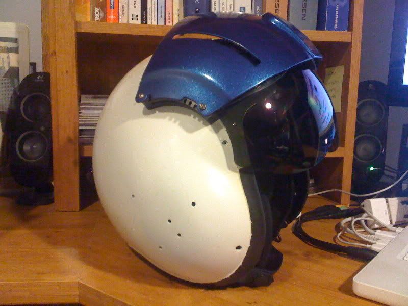

I've finally finished painting the helmet and I installed a new SPH-4 dual visor assembly (that I also painted). Hopefully after Christmas I'll be able to afford some more components.

And this helmet that I am using is the AFH-1. From what I've read it's supposed to be a little better than the APH-5. With an SPH-4 ear cup assembly and a Zetaliner it seems to be pretty comfortable.
