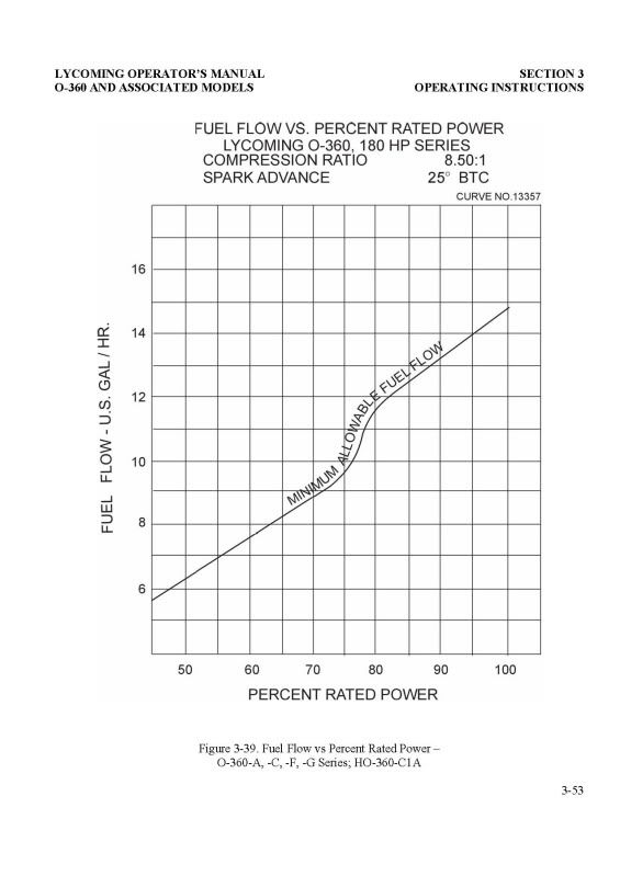

Super Petey-O Posted December 22, 2010 Posted December 22, 2010 Aside from seeing one listing on their brochure (I think it was for the CBi), I can not find any literature on the the fuel consumption rates for the schweizer. It is not even listed in the Pilot's flight manual / HIM. If any one has any good sources or rules of thumb for fuel consumption rates in the S300CB (269C-1) I'd love to hear them. Thanks Quote
lelebebbel Posted December 22, 2010 Posted December 22, 2010 (edited) For some reason you won't find these numbers in flight manuals for most piston machines. Probably a liability thing or something.We have the CBi listed at 45 liters/hour (thats just under 12gal for all you imperialists) in our ops manual, realistically its a bit less than that depending on load, weather, altitude etc. Edit: sorry, you were looking for the CB. That's in there, too, but I can't remember the figure. Edit2 : 300CB and CBI are both listed at 45ltr/hr in there. Edited December 22, 2010 by lelebebbel Quote

iChris Posted December 23, 2010 Posted December 23, 2010 Aside from seeing one listing on their brochure (I think it was for the CBi), I can not find any literature on the the fuel consumption rates for the schweizer. It is not even listed in the Pilot's flight manual / HIM. If any one has any good sources or rules of thumb for fuel consumption rates in the S300CB (269C-1) I'd love to hear them. Thanks Schweizer’s DOC documents quotes the fuel flows for the 300C @ 11.8gph and the 300CBi @ 10.5. So that would place the 300CB some were in between, likely nearer to the CBi. Lycoming charts fuel flow for the HO-360-C1A (CB engine) as shown: Quote
