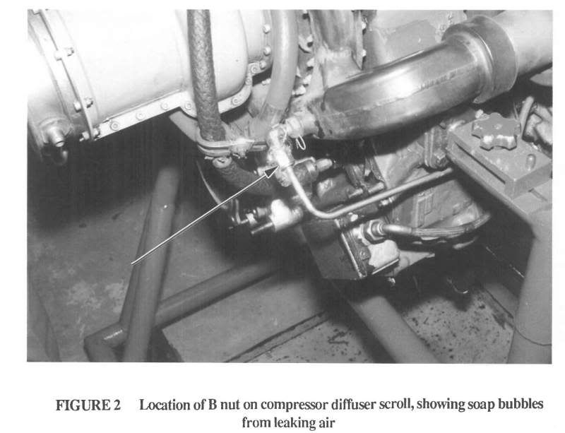

The following is from a fatal accident report related to the 250-C20 and its Compressor delivery pressure (Pc) sensing line.
“Before engine disassembly began, it was found that a pipe running between the compressor diffuser scroll and PT governor was slightly loose. This was traced to a loose nut (of a type known as a 'B' nut), at the union of the pipe with the diffuser scroll. The purpose of the pipe is to supply a reference compressor pressure, Pc, to the fuel control components. In the event that the pipe becomes disconnected, there will be a complete loss of engine power; the gas generator will run down to sub-idle and even flame out. The nut could be turned under firm finger pressure, although the engine manufacturer specifies an assembly torque of 80 to 120 Ib/ins for this and similar unions on the engine. It was established that the union was leaking by disconnecting the Pc pipe at the PT governor and blowing air into it; bubbles appeared after soap solution was applied to the union (see Figure 2). Most of the 'B' nuts on the engine had no 'torque paint' applied to provide an indication of loss of torque during inspections, although a white, crumbling residue was visible on a few. Such residue was found on the loose union, and the two halves of the mark were misaligned by approximately 1/16 inch, ie only a small rotational movement. It was later noted that the application of 80 Ib/ins of torque caused realignment of the marks and also eliminated the leak. The Pc pipe is normally disconnected at the compressor scroll whenever a compressor wash is carried out. The aircraft records indicated that this was last accomplished on 2 October 1993, approximately 30 operating hours before the accident.”
