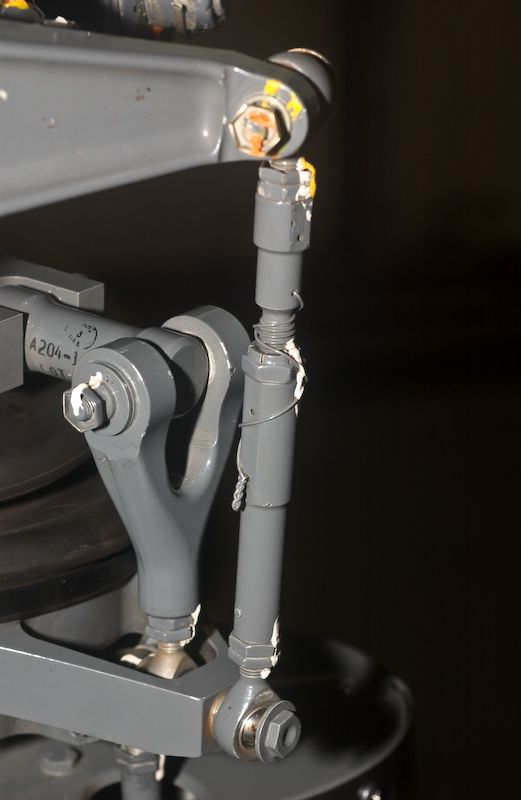

iChris Posted April 15, 2013 Posted April 15, 2013 (edited) The particular helicopter in question is 90 hours out from major overhaul and came from Florida. I'll describe the helicopter, and I'll see what everyone's reaction is: 6) Exposed bolts (i.e. pitch link bolts and lock nuts) show signs of corrosion (i.e. brown) How’s this link in comparisons? It too is a little brown. {Click photo to enlarge} This is more of what you normally see: Edited April 15, 2013 by iChris Quote

Rotortramp Posted April 15, 2013 Author Posted April 15, 2013 How’s this link in comparisons? It too is a little brown. {Click photo to enlarge} Chris, I don't recall the actual condition of the pitch link (hopefully I describe the names of the parts accurately). It was the bolt that was holding the link on the ball joint pictured above. The head of that bolt looked brown and if my memory serves me correctly looked something like this (in terms of color): That may be incorrect as I just remember pointing out and saying "hey that looks kind of brown". So is that bolt going anywhere? Most likely not, but if you start to spin in rapidly, throw in some turbulence, and have it be constantly under load, I then start to think, I'm not sure. Quote

iChris Posted April 15, 2013 Posted April 15, 2013 The head of that bolt looked brown and if my memory serves me correctly looked something like this (in terms of color): That may be incorrect as I just remember pointing out and saying "hey that looks kind of brown". What was their reply to your "hey that looks kind of brown"? Check it out on your next visit and take a photo, could be noteworthy. Quote

Guest pokey Posted April 15, 2013 Posted April 15, 2013 (edited) How’s this link in comparisons? It too is a little brown. {Click photo to enlarge} This is more of what you normally see: that pitch link is the strangest combination i have ever seen,,,,pal nuts, jam nuts nylon/hi temp? locknuts, Does that safety wire even do anything? Must be a robinson with the pal nuts, but the 204 P/N ? & the painted safety wire,,,?? All i like to see in a control system is good old cotter pin, an art to bending them tho, and so is safety wiring.. and this person needs to have his torque stripe laquer confiscated ! or learn what it is for and how to use it Edited April 15, 2013 by pokey Quote

Guest pokey Posted April 16, 2013 Posted April 16, 2013 (edited) i vote to: GROUND IT !! you can ya know ,,,,,,,,,,,,,, we all know you cant do that,,,(well some of us) as far as the bolts go?,, in corrosive enviroments, alot of operators use cosmoline (aka par-al-ketone--((blackbear)) on the exposed heads and nuts, & assemble the parts with mastinox. i personally assemble just about every bolt with mastinox, & if corrosive environment, everything that may rust gets a light coat of black bear,---it looks like a rusty mess, but ? underneath is a brite shining bolt. Some bolts and assemblies cannot be assembled with mastinox tho,, in those instances i use zinc chromate, or even anti-sieze compound. Just because the bolt looks "rusty",,, consult a mechanic that knows a bit about corrosion, or do your research--which is what the original poster is doing here in the 1st place. edited for practical reasons Edited April 16, 2013 by pokey Quote
Rotortramp Posted April 16, 2013 Author Posted April 16, 2013 Pokey, they very well could of used some sort of anti corrosive coating to keep everything nice underneath. The issue is, is that I don't know and nobody else seems keen to find out, unless it is in the logs somewhere. I think the main overlying issue I have is that it was just dropped off by two people nobody knows that well. They could be excellent caretakers or the absolute worst. Considering that the general condition of the helicopter can be categorized as beat, I am assuming the worst; especially being as cautious as I am. Combine that with the environment that it came from and having already been wrecked before puts me over the edge to say "no" and stick to my guns. As mentioned before though, this likely means I don't fly, which will start to anger everyone else, since its a go go go type of school. Quite the predicament, make my potential employer and fellow coworkers happy, or err on the side of caution. Quote
