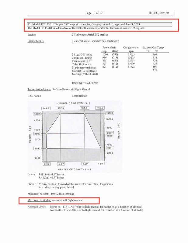

By the way, on which page of the TCDS did you note the conflicting information?
TYPE CERTIFICATE DATA SHEET No. H10EU
Model EC 155B and Model EC155B1
FAR 21.29 and FAR 29 Amendment 29-1 through Amendment 29-40..

In the EC 155 B1 flight manual APPROVED ALT. / TEMP. ENVELOPE IS FROM - 40 TO +50 .
But in the helicopters TYPE CERTIFICATE DATA SHEET due to some modification the operating temp. is
