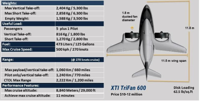

voyagerB Posted May 6, 2018 Posted May 6, 2018 It's a nice design. I once did the numbers though, and came to a disc loading that's more than double that of an Osprey, making flying over and landing/taking off in the built environment virtually impossible. 1 Quote

voyagerB Posted May 7, 2018 Posted May 7, 2018 If you take the concept of a tri fan apart, slim down the parts and free up fan diameter for more efficient disk loading (front ones swivel to operate in fwd mode), you might end up with something like this. Lower CG will also benefit stability. You might even envisage a detachable cabin which constitutes a car if it is lowered onto a chassis... 1 Quote
Eric Hunt Posted May 7, 2018 Posted May 7, 2018 Why is it that the picture posted by Voyager above claims to have 2 x 2500+ hp engines, when the Honeywell website only claims to have 1021 Hp per engine?? 1 Quote
voyagerB Posted May 7, 2018 Posted May 7, 2018 Why is it that the picture posted by Voyager above claims to have 2 x 2500+ hp engines, when the Honeywell website only claims to have 1021 Hp per engine?? Dunno. I just posted some of the promo material I found on the internet. I'll check... But IMO the more serious issue is that the TriFan only makes sense if it's reasonably point to point. But with those fans I don't to see the TriFan getting clearance to land close to one's destination. The TriFan will need to land at an airport. And that raises the question: why have such expensive VTOL capability? 1 Quote
