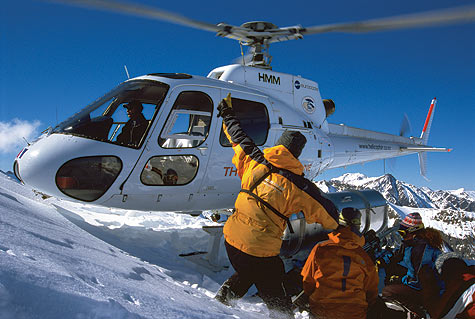

Bummer.. I worked for a company in New Zealand that had Pods on the AS 350 and 355's the Pods were Metal mesh on the bottom and then had a solid or mesh hinged top with a latching lid with a carabiener or something through the latch.. worked great and you could fit a raft in them too..

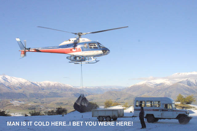

Althought this picture has no Pods it does have a wicked sling load and a helicopter full of raft guides..

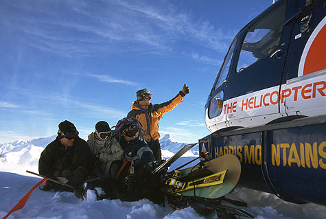

Or this AS350
not mesh but lidded..
ONE MORE....

LostHeliBoy; are those baskets in the pics you posted home made??? They look heavy, and I dont know how it works in NZ but the FAA frowns on attaching shop built external load carrying devices to helicopters. Looks like great skiing though.
Nearly everything in NZ seems to be home made..
No really they have some great small time manifactures that make great aluminum baskets..
I was working around them as a raft guide not a ski guide in the winter and we could slide a properly rolled raft into one of them they are huge! the FAA wants to STC everything.. The CAA wants you to be safe and take Due course to protect passengers and "innocents" its a bit more lax.. 90% of the country is "G" airspace. and the operators are working on very thin margins. . and flying in some of the most beutiful country in the world.. Steep and green with glaciers and the ocean all really close.. similar to alaska.. but with more sheep and tourists.. and hobbits too.

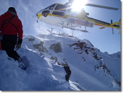

Here's a photo of the one I flew with when flying for Coastal (I believe it is the Dart Basket mentioned above). It worked really good and the bungee actually keeps the top locked down over the latching mechanism.
