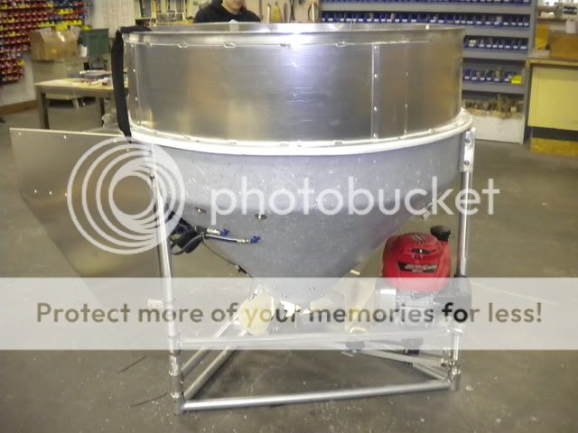

We sell a 20 cubic foot seeder bucket appropriate for the R44. It weighs under 150 pounds! Give me a call at ISOLAIR 503-492-2105DSCN1598.jpg
