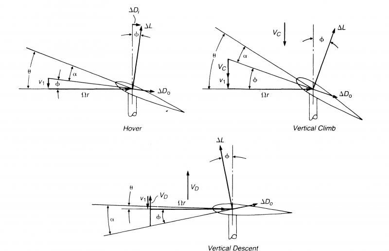

Jay Bunning Posted October 9, 2013 Posted October 9, 2013 (edited) Question: Which would produce the slowest rotor RPM? A: A vertical descent with power. B: A vertical descent without power. C: Pushing over after a steep climb. Edited October 22, 2013 by Jay Bunning Quote
WolftalonID Posted October 9, 2013 Posted October 9, 2013 (edited) In a climb you have high pitch settings. This is the cause for the low rpm. Its called high drag profile. I may be mistaken and would need to verify with my test book, but this question I believe was related to gyroplanes. They dont have engine driven rotors except during initial climb..I think.... Even if that last part is wrong, in a decent, we are using autorotational forces and low pitch settings which reduce our drag profile. Engines have limited power, the higher the pitch setting the more they work. The easier to get low rotor rpm. Ok edited input here. In a climb your wind is coming from above the rotor disk and the relative wind to the pitch angle of the rotor blade is positive but not at an angle to exceed lift. If at the top of the climb you push over instead of lower collective, you move upward movement to forward movement. This changes relative wind from above in the climb to in front. Pitch angle has not changed and results in relative wind striking a high pitch angle, exceeding the angle capable of producing lift, and or an angle that exceeds available power and you get rotor droop, or low rotor rpm. The same principle when we recover from low rotor rpm, we lower collective, AFT cyclic, roll on power. Reducing pitch attitude of the airfoil and increasing our rpm with power and using wind power under the disk. The same principle in an engine out drill. Lower collective and AFT cyclic. Never push over. We fly rotor craft, not fixed airfoil craft. Rotor energy is controlled by collective and power. Thats why they are on the same stick. Final edit: after review of my FAA test book, the question found on page 2-18 of ASA commercial test prep had no direct indication it was for gyroplanes. Therefore I apologize for taking up reader time in my initial guess work that it may have been. Basic aerodynamics of the rotor do reflect why the answer is what it is, and i agree the FAA explanation is rather copoutish. One might want to review relative wind, angle of attack, induced drag to understand what is being implied by this Government eval test. Edited October 9, 2013 by WolftalonID Quote

iChris Posted October 10, 2013 Posted October 10, 2013 (edited) Could someone help me understand WHY in a power-on situation, at the top of a climb a pushing forward of cyclic would lower RPM? Many thanks in advance and see question below: Question: Which would produce the slowest rotor RPM?A: A vertical descent with power.B: A vertical descent without power.C: Pushing over after a steep climb. That test question #5672 is somewhat ambiguous for a helicopter question and the answer seems to imply that a cyclic pushover after a steep climb (power-on) would cause a lowering of the RPM. In general, it's a poor test question without much relevance to a students study. However, the question actually seems to be asking, which of the three choices would potentially produce the slowest rotor RPM prior to corrective action via governor or manual intervention. In that context it’s the one that is highest in power required and/or has the highest drag. In most cases were a constant available power is being applied to the rotors system, any decay in rotor speed (RPM) is a function of the power required and of the rotor’s level of kinetic energy. Therefore, this type of question can be approached from the perspective of the power required vs. power available. If the power available were fixed at a constant value, any increase in the power required would normally cause a decrease in RPM. If on the other hand the power required decreased, the excess in power available would increase RPM. Induced drag works along the same line. Increased induced drag equals a decrease in RPM. Inversely, decreasing induced drag yields an increase in RPM. In any case from the figure below, you can see, a vertical descent has the least amount of drag and requires the least amount of power vs. the cyclic pushover. Therefore, the cyclic pushover from a climb yields the best potential for the slowest rotor RPM out of the three choices. Φ = inflow angleθ = blade pitchα = angle of attackVi = induced velocityVc = climb velocityDi = induced dragDo = profile dragΔL = lift vector Edited October 19, 2013 by iChris 1 Quote
