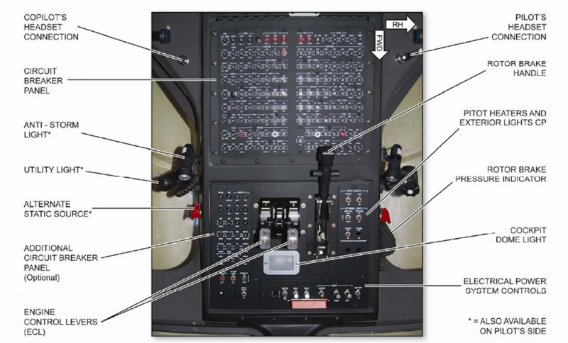

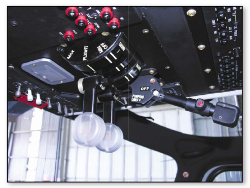

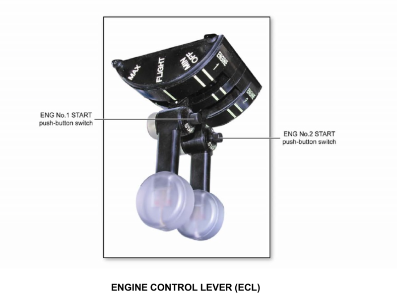

The Engine Control Levers and the Rotor Brake Handle seems to be what you're talking about. The basic behaviors of these controls is common to those of newer twin-engine helicopters with over head engine controls and rotor brake.

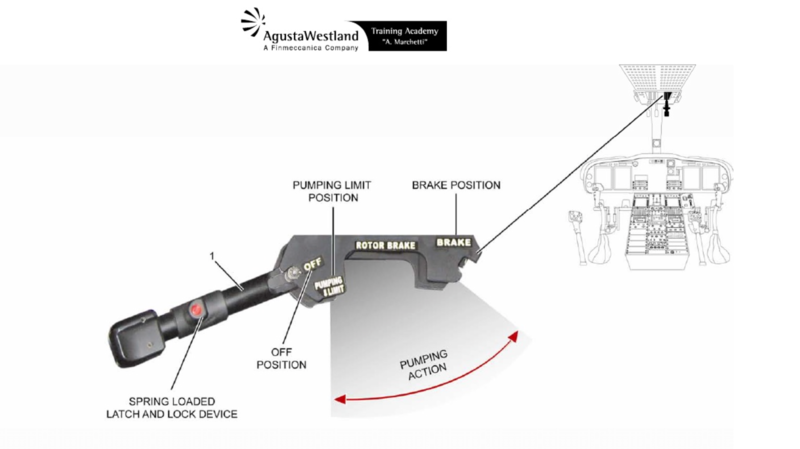

There’s no, so called, lever between the rotor brake control lever (RBCL) and the rotor brake control module (RBCM). However, there’s a mechanical linkage from the RBCL that manipulates the pump and outlet valve at the RBCM.
