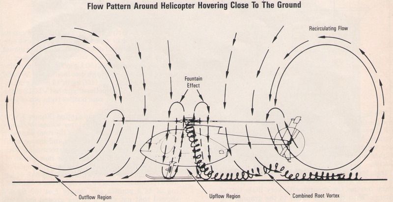

It’s not surprising given the turbulent flow all, piston and turbine, helicopters operate in while hovering and on the ground with the rotors turning, take a look at the figure below. The fact that the heater was on could also be an issue given any exhaust leaks or exhaust recirculation during prolonged hovering.
