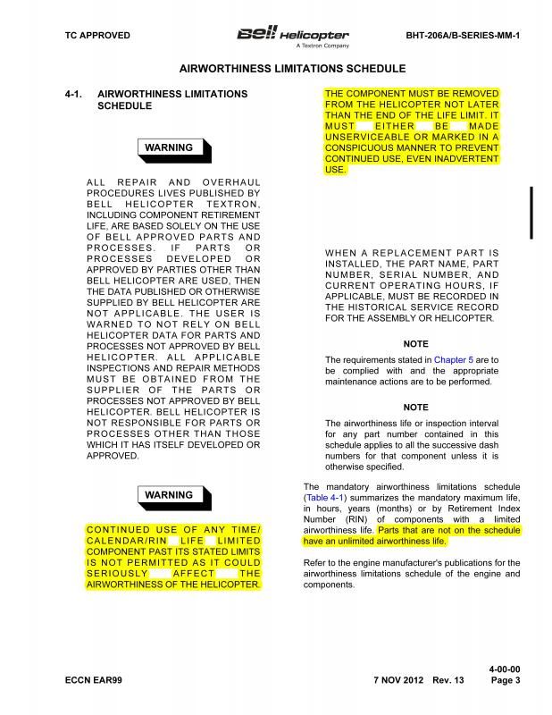

avbug Posted September 18, 2014 Posted September 18, 2014 You are required to do the 100 hour inspections, unless you use an approved inspection program in lieu of the 100 hour regime. In either case, you are required to comply with all the life limited and time limited component replacement and inspection intervals spelled out in the maintenance publications by the manufacturer or airworthiness section of the aircraft flight manual. The original question pertained to exceeding the 100 hour inspection interval during a revenue flight. This is not acceptable. If you know that the flight will exceed the upcoming inspection interval, then you don't have enough time available on the aircraft to conduct that flight. Perform the inspection. Someone commented that a special flight permit ("ferry permit") is required to move the aircraft after the 100 hour point. This is not the case, as the regulation already provides that one may move the aircraft following the inspection interval. Moreover, if one doesn't intend to carry passengers for hire, one can fly it another hundred hours without the inspection, if one desires, without being in violation of the regulation (unless the aircraft is under an approved maintenance program requiring that inspection). For example, one is at hour 99 and flies a passenger for 45 minutes. One then takes a 40 hour personal flight in the aircraft. A 100 hour inspection is not required until one intends to fly passengers for hire again. The purpose of the inspection is the subsequent flying, not past flying; in other words one isn't inspecting the aircraft to ensure it's safe for passenger flights that have already been flown. One is inspecting it for flights yet to come. If one no longer intends to operate the aircraft in a manner requiring the 100 hour inspections, one doesn't need to do them any longer. If one hasn't elected to operate under an alternate inspection program, however (eg, 91409(e)), then one must continue the inspection intervals and deduct the transit time to an inspection facility. As always, the devil is in the details, and specifics of the operation matter. Once the 100 hour inspection has been accomplished (again, the equivalent of an annual inspection, the same as alternative inspection programs that must equal an annual inspection every 12 calendar months), the 100 hour time period for flying passengers for hire is reset. If one is doing continuous flying of passengers for hire and is operating under 91.409( b ) in maintaining those 100 hour inspections, one could fly until hour 99, fly the passenger for 45 minutes, and land. Then one could fly 5 hours and fifteen minutes to the inspection facility, and have the 100 hour inspection performed. One then has 95 hours before the next 100 hour is due. A special flight permit was not required to fly to the inspection facility. Quote

avbug Posted September 19, 2014 Posted September 19, 2014 The operator of a turbine powered helicopter who elects to operate under 100 hour inspections instead of an alternate inspection program is still bound and beholden to the requirement of 91.409(e), with respect to compliance with all component limitations. This requirement exists regardless of whether one elects to pursue a 100 hour inspection program, or an alternate program under 91.409(f). This requirement exists if the rotorcraft is maintained under 91.409( b ) with 100 hour inspections, and it exists if the rotorcraft is inspected under an alternate inspection program (eg, progressive inspection) under 91.409(f). Quote

avbug Posted September 20, 2014 Posted September 20, 2014 (edited) Avnut: Nope! Negative, gramps. Not true. Can't you read? Parts (a) and (b ) give you the OPTION of adhering to part (e). If you do ELECT to choose part (e) then you must specify a progressive inspection program defined in part (f). Part (e) does not apply. YOU DO NOT HAVE TO GO BY PART (e). If that were the case, the FAA would have specified in parts (a) and (b ) that stuff about retirement times and component limitations. But they did not. Read it for yourself. Read it slowly. 91.409(b ) (4) doesn't say that you *have* to go by one of the inspection programs listed in subpart (f). It only says that you *can*. You *may*. But you can continue to march and go by (a) and (b ) and forget about the (e) if you like. I'm telling you, the FAA has affimed this - under Part-91 of course, not Part-135. I wish it was not the case - really! But it is. I read quite well. Well enough to have been assigned as Director of Maintenance at two different operations (but maybe it was a fluke). You aren't very good at it, however, so for the benefit of those who might mistakenly believe your misunderstanding of the regulation, we'll tackle it again. To start with, there is NOTHING in 91.409(a) or 91.409( b ) which stipulates that compliance with 91.409(e) is unnecessary. Nothing. Let's look at it again. (a) Except as provided in paragraph © of this section, no person may operate an aircraft unless, within the preceding 12 calendar months, it has had—(1) An annual inspection in accordance with part 43 of this chapter and has been approved for return to service by a person authorized by §43.7 of this chapter; or(2) An inspection for the issuance of an airworthiness certificate in accordance with part 21 of this chapter.No inspection performed under paragraph ( b ) of this section may be substituted for any inspection required by this paragraph unless it is performed by a person authorized to perform annual inspections and is entered as an “annual” inspection in the required maintenance records.( b ) Except as provided in paragraph © of this section, no person may operate an aircraft carrying any person (other than a crewmember) for hire, and no person may give flight instruction for hire in an aircraft which that person provides, unless within the preceding 100 hours of time in service the aircraft has received an annual or 100-hour inspection and been approved for return to service in accordance with part 43 of this chapter or has received an inspection for the issuance of an airworthiness certificate in accordance with part 21 of this chapter. The 100-hour limitation may be exceeded by not more than 10 hours while en route to reach a place where the inspection can be done. The excess time used to reach a place where the inspection can be done must be included in computing the next 100 hours of time in service. 91.109(a) provides that an annual inspection, or the equivalent thereof, must be performed within every 12 calendar month period. This may be a single inspection (an "annual"), or it may be a series of inspections over the duration of that 12 calendar month period. 100 hour inspections, while required to be the same scope and equal in performance and detail to an annual inspection, do not cover the requirement of 91.409(a) unless performed by an IA and signed off as an annual. Those not wishing to comply with the requirement of an annual may use an approved inspection program (eg, a "progressive" inspection or continuous airworthiness inspection), referenced later in the regulation. An airworthiness certificate conformity inspection may also fulfill the requirement of an annual. 91.409( b ) sets the requirement for 100 hour inspections. These are mandatory, unless an alternate inspection program has been approved by the Administrator, and selected by the operator. 91.409 ( b ) makes no reference to 91.409(e), and does NOT relieve the owner/operator of meeting the airworthiness requirements of 91.409(e). Nothing in 91.409(a) or ( b ) references subparagraph (e), and nothing in the former two paragraphs (a and b ) make any reference to (e). Moving on...91.409© establishes that a turbine helicopter does NOT need to comply with the annual inspection requirement or the 100 hour inspection requirements of (a) or ( b ) IF the operator elects to use an alternate approved inspection program in accordance with subparagraph F. Regardless of whether the operator elects to use 91.409(a) for the annual and ( b ) for the 100 hour, or instead uses an alternate inspection program under 91.409(f), the owner/operator MUST comply with subparagraph 91.409(e)'s requirement to respect life limitations and replacement times. This requirement is not removed by performing an annual or 100 hour inspection. You said that 91.409(a) and ( b ) give the option of complying with 91.409(e), and this is NOT the case. There is no language in eithef (a) or ( b ) referencing (e) or in any way hinting or suggesting that compliance with (e) is not mandatory. None. You may be thinking of subparagraph (f) when you are saying (e), and if that is the case, then yes, the operator does not need to select an alternate inspection program under (f). The operator may wish to stick with a plain-jane annual, and perform 100 hour inspections (in accordance with (a) and ( b )). The operator is still beholden to (e). The operator may elect to seek approval under an alternate inspection program under (f). The operator is STILL beholden to (e). It's really not that complicated, although you certainly seem have a hard time understanding it. Edited September 20, 2014 by avbug 1 Quote
Nearly Retired Posted September 20, 2014 Posted September 20, 2014 Well I'll give you that, gramps, there is nothing in 91.409 (a) or (b ) about part (e). You're right. I misspoke if I said that they did. The clarification actually comes in 91.409(c ). It is there that you find the wording that turbine helicopter operators *MAY* elect to go by part (e). If they do not *elect* to go by part (e), then parts (a) and (b ) apply. You may THINK that part (e) is mandatory, but I assure you it is not. And again I implore you...beg you...read part (e) again. When you do, you'll find that the first part...the part that deals with component times, etc. applies but they say "AND" when you choose one of the various progression inspection programs. Look, I'll break it down for you: No person may operate a... turbine-powered rotorcraft... unless the replacement times for life-limited parts specified in the aircraft specifications, type data sheets, or other documents approved by the Administrator are complied with... AND... the turbine-powered rotorcraft, including the airframe, engines, propellers, rotors, appliances, survival equipment, and emergency equipment... is inspected in accordance with an inspection program selected under the provisions of paragraph (f) of this section... Okay, got that? Both of those clauses go together. The first part...that bit about inspections, is linked to the second part...that bit about choosing a progressive inspection program. But again, all this is irrelevant if you simply choose to go by 91.409(a) and (b ). In fact, part (e) even repeats it! ...except that, the owner or operator of a turbine-powered rotorcraft may elect to use the inspection provisions of §91.409(a), (b ), (c ), or (d) in lieu of an inspection option of §91.409(f). And if you choose to go by (a) or (b ), then you don't have to go by (e ). Here is how I know this. When I was with FH1100 Manufacturing, there was one of "our" ships (manufactured before my friend bought the TC) which had components that were over their life limit. We knew this for a fact. We wanted the ship grounded; the owner told us to go screw off. He sent us a copy of a letter from the FAA in Washington that said, basically, that life limits do *not* apply under Part 91! We were flabbergasted to say the least. And there was nothing we could do. Separately, I also had an A&P/IA come to me one day with a hypothetical situation. And this guy was sharp - he was no corner-cutter or schlub. He asked, "Suppose I Annual my own ship, but the tail rotor blades only have 25 hours left on their life at the time of the Inspection. They are not timed-out, so I sign the Annual off. I end up flying the ship over 25 hours that year. Am I illegal?" I had to stop and scratch my head. My gut reaction was, "You cannot overfly a life-limited component." Because logically...emotionally we *want* the operator/pilot to be responsible for adhering to the component life-limits. But the FAA does not look at it that way, as we found out with the FH1100 (which ultimately ended up crashing when the guy ran it out of fuel, by the way). I know that historically we consider finite life limits to be mandatory for all helicopters (piston and turbine) operated under all parts. We've thought that way for so long that we get to believing that the regulations require it. But we are wrong. And by "we", I mean Avbug. 1 Quote
iChris Posted September 21, 2014 Posted September 21, 2014 (edited) Although paragraph [e] of § 91.409, permits "the operator of a turbine-powered rotorcraft to elect to use the inspection provisions of § 91.409[a], , [c], or (d] in lieu of an inspection option of section 91.409(f)," paragraph [c] specifically states that paragraph [a] and of that section do not apply to "an aircraft that carries ... a current experimental certificate" or to "turbine powered rotorcraft when the operator elects to inspect that rotorcraft in accordance with paragraph [e] of this section." This applies to the options of inspection requirements not the replacement of life-limited parts under §91.409 [e]. You are not given an option with respect to the replacement of life-limited parts since you are still bound by §43.16. However, The key is to determine if the limit is mandatory or just a manufactures recommendation. It’s like the Robinson R22 limit at 2200 hours or the engine overhaul requirement, not mandatory under Part 91. See the 2011 link: R22 Airworthiness past 2200 hrs. § 43.10 - Life-limited part means any part for which a mandatory replacement limit is specified in the type design, the Instructions for Continued Airworthiness, or the maintenance manual. REF: FAA Order 8620.2: 9. Life Limits and Placarding. Adherence to component life limit retirement times listed on a TCDS is required by §43.16 or §91.409(e), and a requirement to follow placard instructions is required by § 91.9(a). “Some OEM’s have placed mandatory language such as “shall,” “must,” and “will” on their TCDS that imply that compliance with TCDS notes is mandatory. However, in the absence of regulatory language, or an AD that makes such TCDS notes mandatory, compliance with such notes is not mandatory. REF LINKS: FAA Order 8620.2A - Applicability and Enforcement of Manufacturer’s Data Legal Interpretation on the Use of Manufacturers' Publications to Determine Inspection Intervals and Replacement Times; MacMillan 2011 CLICK PHOTO TO ENLARGE Edited September 22, 2014 by iChris 1 Quote
