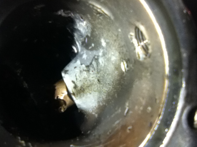

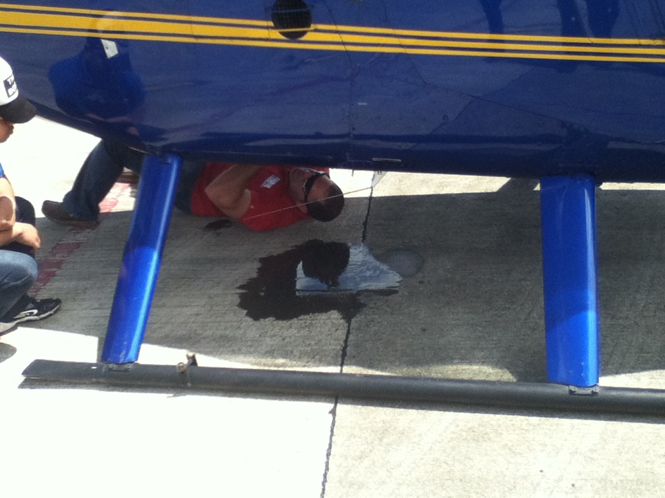

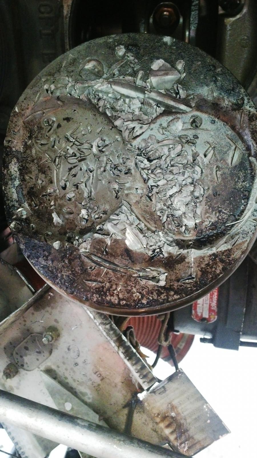

mausermolt Posted May 18, 2013 Author Posted May 18, 2013 I think everyone can gather what happened from these two pic's...made me a bit sick when i saw them Quote
lelebebbel Posted May 19, 2013 Posted May 19, 2013 Ah, the good old Lycoming stuck exhaust valve. Did it bend the push rod as well? Quote
mausermolt Posted May 19, 2013 Author Posted May 19, 2013 no bent pushrods, Valve just snapped off Quote
mausermolt Posted July 3, 2013 Author Posted July 3, 2013 well my engine finally made it back to the factory for inspection and overhaul. they are saying that the broken valve was probably due to an engine overspeed from snapping on the throttle after a practice auto. as this is not a training helicopter and we dont do many auto's i find that unlikely. i have done a few auto's by myself in the helicopter just to keep fresh but i havent overspeed it. could either be Robinson just dosent want to admit fault, OR a previous pilot overspeed it and didnt tell anyone. ive been told my helicopter is expected to be returned to service by the end of July...yeah right.either way, im just sittin around with no helicopter and nothing to do. at least im getting paid! Quote

mausermolt Posted July 4, 2013 Author Posted July 4, 2013 also come to find out all 6 of the cylinders had lost compression for some reason. anybody have any clues as to why one valve goes Kaput and the rest of the engine follows suit? Quote
rick1128 Posted July 4, 2013 Posted July 4, 2013 also come to find out all 6 of the cylinders had lost compression for some reason. anybody have any clues as to why one valve goes Kaput and the rest of the engine follows suit?I have seen it before. Pieces of the valve migrate through the engine. It really doesn't take much. 1 Quote
gary-mike Posted July 4, 2013 Posted July 4, 2013 Wear metal and especially chunks of broke parts cause a lot of damage quick. Not quite as quick as a blade separation in a turbine that "corn cobs" the entire compressor an takes out the turbines...but still pretty quick. Quote
500E Posted July 4, 2013 Posted July 4, 2013 What do the rest of Cylinders look like there must be a reason for low compression ?The Ex valve looks like it is tuliping as well or is that just photo. Quote
mausermolt Posted July 5, 2013 Author Posted July 5, 2013 the rest of the cylinders looked fine. no visible damage at all. thats why i was a bit confused on why they would loose compression. Quote
